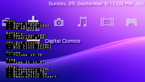

Nome File: GetInfo v1.2

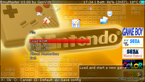

Nome File: EmuMaster v3.1 Unofficial
